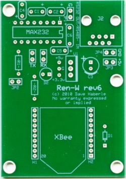

== '''PCB Parts Layout''' == | == '''PCB Parts Layout''' == | ||
: The only important difference between the standard board and the SMA board is the orientation of the XBee modules. The standard board has the modules pointing upward; the SMA version has them pointing downward to allow for the long RPSMA antenna connector. Pay careful attention to the orientation of the XBee when plugging it into the board. If you have the standard board, plugging in an XBee module with an SMA connector upside-down will NOT WORK. Likewise, plugging in an XBee with a 1" whip the wrong way on an SMA board won't work, either. | : The only important difference between the standard board and the SMA board is the orientation of the XBee modules. The standard board has the modules pointing upward; the SMA version has them pointing downward to allow for the long RPSMA antenna connector. Pay careful attention to the orientation of the XBee when plugging it into the board. If you have the standard board, plugging in an XBee module with an SMA connector upside-down will NOT WORK. Likewise, plugging in an XBee with a 1" whip the wrong way on an SMA board won't work, either. | ||
::[[File:Ren-w_parts_location.JPG |600px]] | : The Rev6 version of the board has space for only one XBee module and uses a jumper to make the board be either a transmitter (TX) or receiver (RX). The Rev6 board cannot function as a repeater board as it has only one RJ45 jack, but it is about 30% smaller in size and has fewer parts so it's slightly less expensive to build. | ||
::[[File:Ren-w_parts_location.JPG |600px]] [[File:Renwrev6.jpg |250px]] | |||

PCB Parts Layout
- The only important difference between the standard board and the SMA board is the orientation of the XBee modules. The standard board has the modules pointing upward; the SMA version has them pointing downward to allow for the long RPSMA antenna connector. Pay careful attention to the orientation of the XBee when plugging it into the board. If you have the standard board, plugging in an XBee module with an SMA connector upside-down will NOT WORK. Likewise, plugging in an XBee with a 1" whip the wrong way on an SMA board won't work, either.
- The Rev6 version of the board has space for only one XBee module and uses a jumper to make the board be either a transmitter (TX) or receiver (RX). The Rev6 board cannot function as a repeater board as it has only one RJ45 jack, but it is about 30% smaller in size and has fewer parts so it's slightly less expensive to build.
